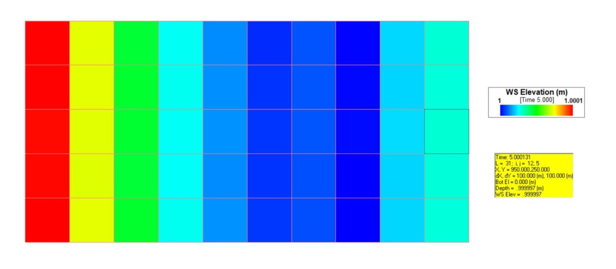

I build a steady state model to learn how EE process the “rainfall”. The model is attached in the attachments. As Fig.a shows, the model has an inflow boundary and a out flow boundary. Their flow vaule is the same. There is a fictitious atmospheric series and a wind series. The rainfall in this atmospheric is 1 m/d. This rainfall is so large that it must make the water level up to approximately 2 m (Initial water level is 1 m).But the water level at Day 5 is still about 1m (Fig.b), not 2m. It implies that the rainfall have no influence. Why does this happen?By the way, why do I must have a “Wind” series if I choose to simulate the temperature? Or it will have an error.

Hi Tom, the water level still cannot rise 1 m (the rainfall) when I have opened the Temperature Module (Fig-0). It is still 1 m instead of 2 m. Please help me.By the way, in §4.2 of “THEORETICAL & COMPUTATIONAL ASPECTS OF EFDC+” (Fig-a), there is a basic equation of water temperature. However, I cannot find which term is associated with the wind field. Could you explain more about why “The equations that govern temperature in a water body require … the wind field”?
