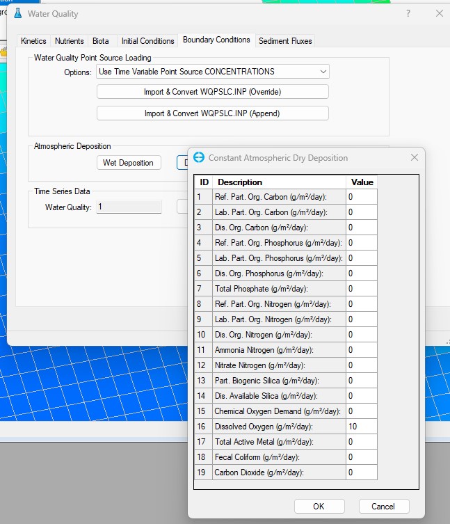

Thankyou for your response. However, I do not follow your answer. My version ofthe GUI 10.3.10 has the option for dry deposition (see image below). And dry deposition worked when I used it.

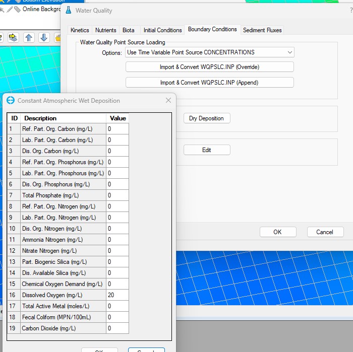

It also shows the option for wet deposition, and it does not work. I have constant rainfall > 0 and WQ concentrations > 0, but it does not add to the water column. I am setting the rainfall in the Atmospheric “External TIme Series” and using ET = 0.
“Wet Deposition” and “Dry Deposition” options are always displayed in the EEMS GUI as you just showed. What I meant about the missing in the EEMS GUI is a parameter that tells the EFDC+ code that the “Dry Deposition” will be used when running the model.
Could you please send me the WQ input file “wq_3dwc.jnp” from your model and two pictures showing the setting of WQ concentration “Wet Deposition” and “Dry Deposition” from the GUI. I’d like to check if there is any error between the input file and the GUI.

Thank you. I am trying to attach the requested file but am told that I am limited to certain file extensions (i.e. *,.jpg etc.) Also I am lmiited to one attachment. So the dry deposition image is attached and I will send the wet deposition next.
Note that I am currently simulation DO only as a test, with rearation, SOD and either wet or dry deposition. So even though wet and dry deposition are set to 20 mg/L I set one of them back to zero for a simulation.

However, for “wet deposition” option, the loading is associated to the rain fall condition. We can only see the change in the concentration during the raining period. I have run a test with using this option for loading DO and the results are shown in the attached photos.
So please try again the “wet deposition” and make sure the rain fall is positive in the Aser time series to see if the option works. As the concentration will be multiplied by the rain fall before adding to the water surface, you may need a high value of rain fall to see the change in the result.
