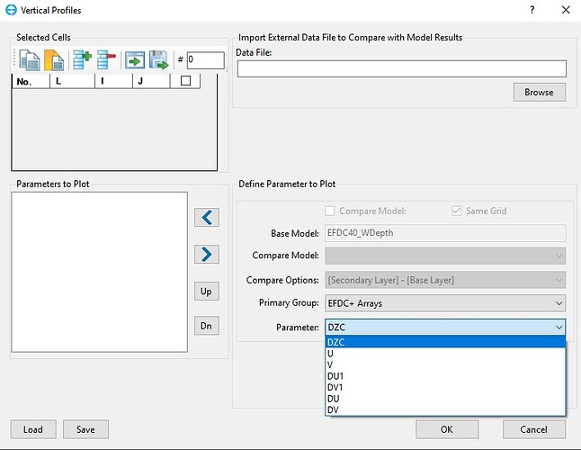

Dear EEMS Team
I’m using version 12 and I can´t export the vertical eddy viscosity. In the EFDC+ arrays, the AV parameter is not available.
Can I export it from version 12?
Thank you for any help.
It seems some of the array options were inadvertently removed. We will add them back for the upcoming release of EEMS 12.3.
