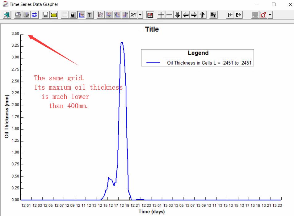

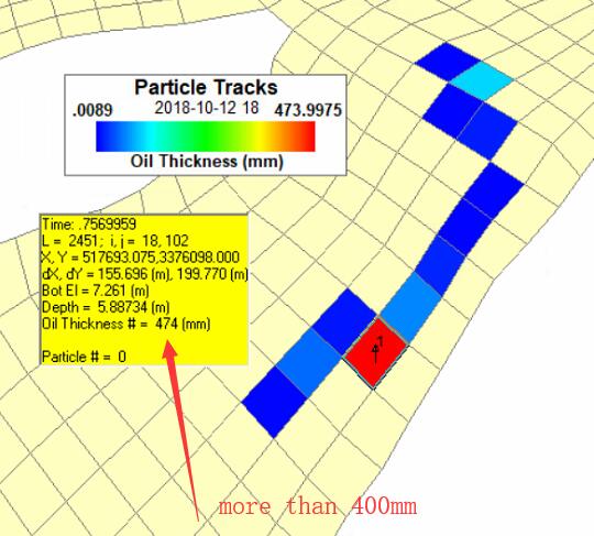

I learned to model oil spill. When I looked the modeled results, I find that the same grid has “two different oil depths”. The two results are orders different (474mm V.S. 3.25mm). One value is seen according to click the grid; the other is seen by time series. You can see them in “Oil_1.jpg” and “Oil_2.jpg”. Why there are two values for one grid?
We have reproduced this issue. The reason for the different values is that what is displayed in the time series is dependent on the option selected for the particle tracks time history in the display options as attached. If you select “Current position”, the value will be the same between ViewPlan and the time series. However, if you select “Display to current time” in ViewPlan the value of the oil spill will then accumulate up to the current time step.
