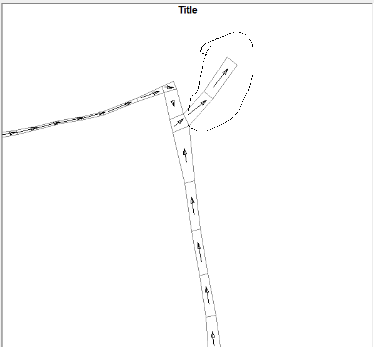

Dear EFDC team and users: How to define the direction of flow boundary conditions? I used the momentum options but it didn’t work. As is shown in the picture, the flow of water is contrary to reality.
Try multiplying the discharge time series that is used for that boundary condition by -1. That will reverse the sign and the direction of flow for that boundary.
