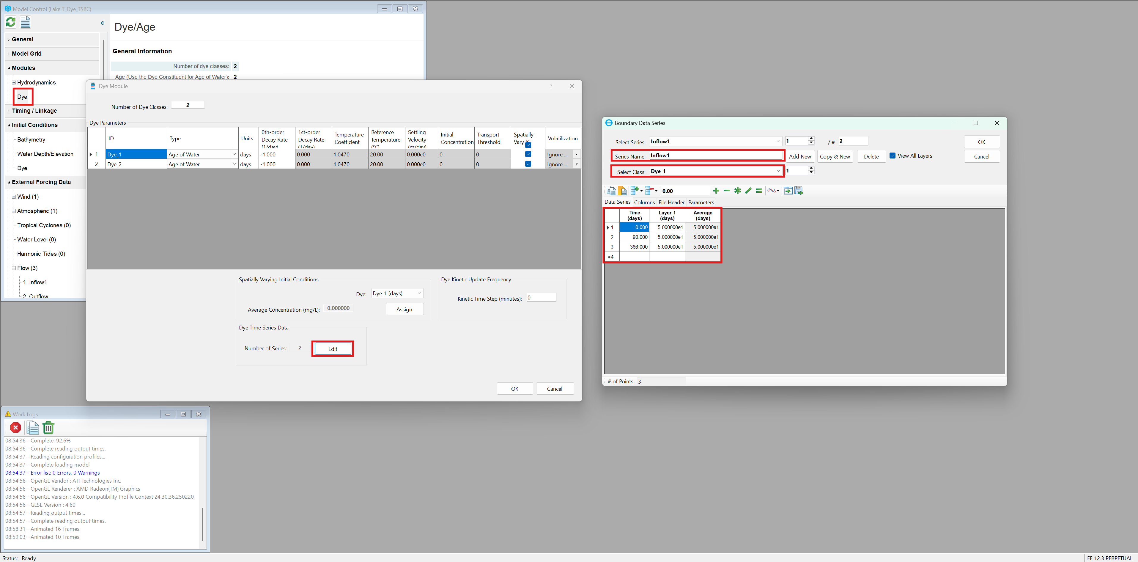

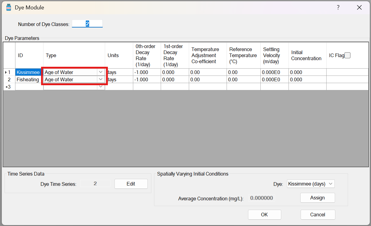

Using the multiple dye option, you can set a 0-order equation for a dye at each inflow. You can then specify the coefficient rate as -1 to calculate the age of water for each dye.
https://eemodelingsystem.atlassian.net/wiki/spaces/EK/pages/240222322/Dye

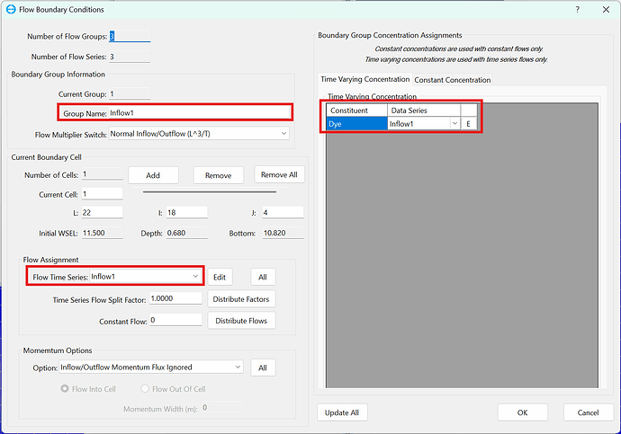

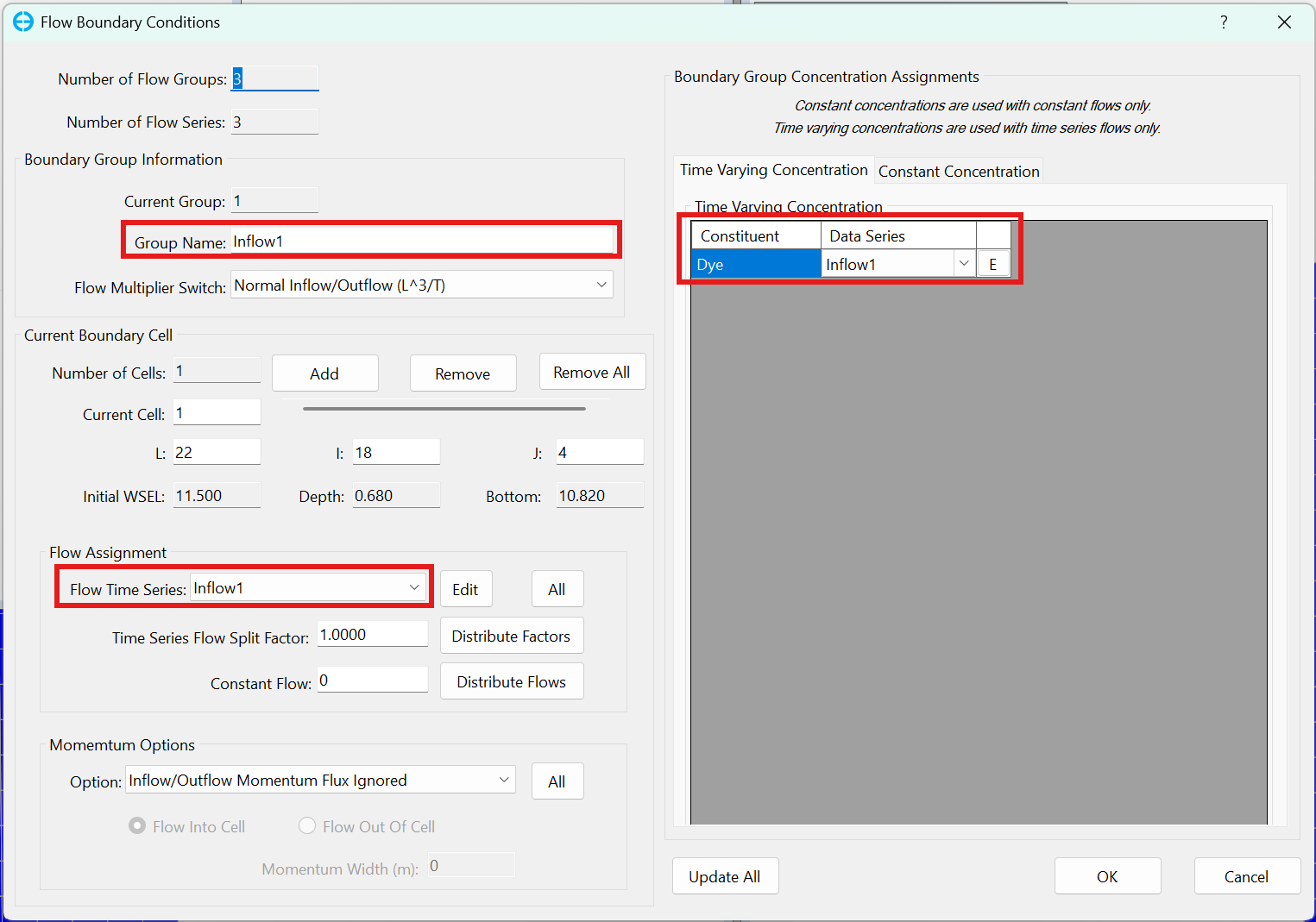

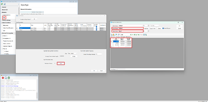

Suppose you have five inflow sources and you’re interested in analyzing the water age from two of them. You set up two dye tracers, assigned to different classes, and designated them as “age” in the setup. However, both tracers produced identical age distributions in the model output.
How can I ensure that each dye class is correctly linked to the specific inflow I’m targeting? Is there a step I might have missed in setting up the dye classes or boundary assignments? Any guidance would be appreciated
You can set a different dye class to each inflow and then set to age of water. Be sure to set them as time varying. We have checked this with EEMS 10.3 and later and it gives results as expected.
