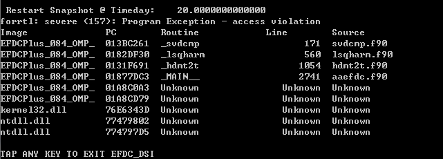

Dear EE teamThe model was run for 20 days to fix the open boundary, and the harmonic analysis(efdc.inp c82) was performed only for 15 days.However, there is a continuous error.I can’t sovled this error at ee8.4I attached my efdc.inp & error pictureI would like to ask for a solutionThanks

Thank you for you Answer…but your answer is not my question…my problem is why this error message… i dont know exactily…
