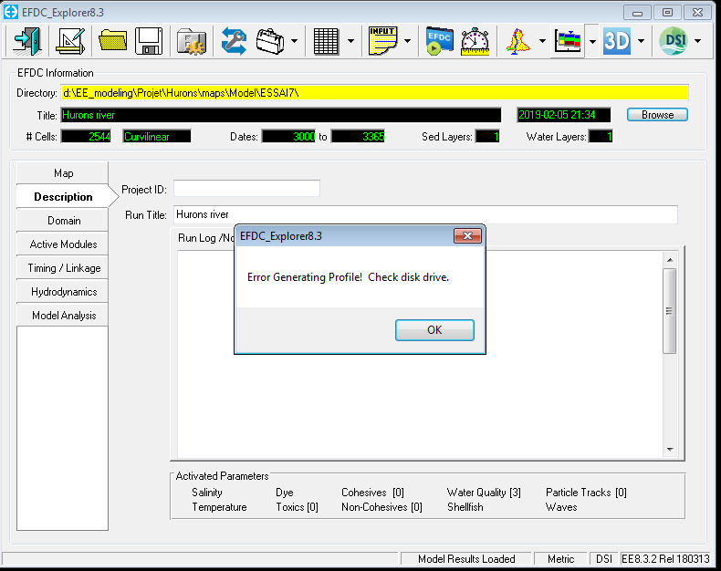

HI, When i tried to check the results of my simulation at a given position (line or point), E_E give me this error. Even when i tried to check initial conditions, he completely refuse to do so. The error is : “Error Generating Profile, Check Disk Drive” Anyone meet this problem before ? I’m totally out. I don’t know what is happening Thanks
It seems likely that the file path for some of the model files is invalid. Are you sure that all the input files for EE are in the correct folder? It looks like you are trying to use the ViewProfile option, and so maybe your drapeline file cannot be found. If you cannot resolve the issue please zip up the model (excluding #output) and attach it for us to look at.
