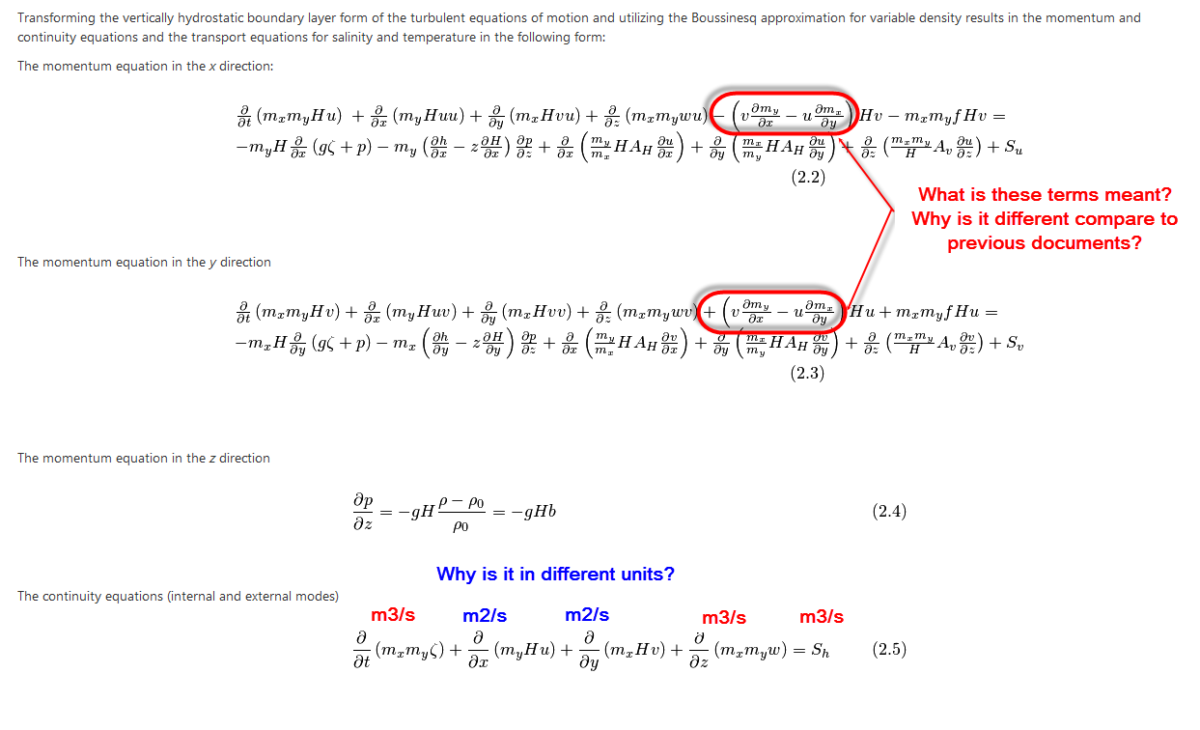

Dear Sir,I found some in the document of EFDC+ theory. And unbalance dimensional unit in continuty equation.https://eemodelingsystem.atlassian.net/wiki/spaces/ETG/pages/2345115/2.1.2+Basic+Hydrodynamic+EquationsIf everyone knows the answer, please let me know.Thank you
2017/12/EFDC-questions.png
Can anyone give me the answer for these strange terms and unbalance units in the governing equations?
Thank you for your question. The terms you are asking about allow for changing the coordinate system. The terms after those in red (mx.my.f.H.v) allow for the the Coriolis effect. In terms of units, they are consistent as mx, my, m, and dz are all dimensionless. So Sh is m/s. We have updated the page to make this clearer.
