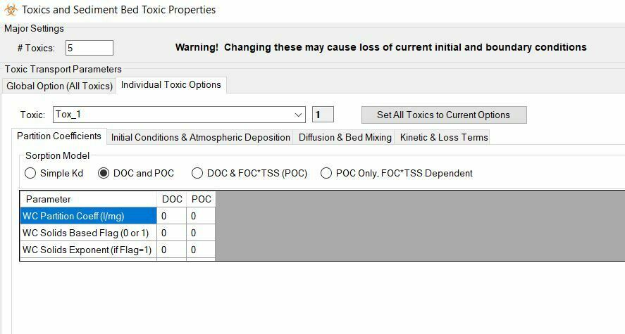

Hello!I am using EEMS 10.2.2 and I am using the Toxics module. I am not able to enter the partition coefficients for DOC and POC for the individual toxics. Once I enter the values and go to the next toxic, the previous values revert to zero. How can I get around this bug?Thanks,Adithya
Hi Adithya, we checked that and can confirm it is a bug. Thanks for alerting us to it. We will fix it in the next update.
Thank you for your response! When will the next update be available? And is there an option to “spatially vary” the partition coefficients?Thanks,Adithya
Sorry for not responding sooner. EE10.2.3 was released last month and had the bug fix for this issue. We plan to release 10.2.4 today or tomorrow so you should probably wait for that to update. Partition co-efficents cannot be spatially varied at this stage.
