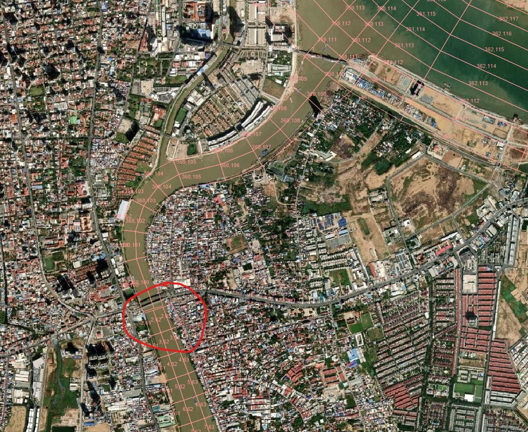

Hi,

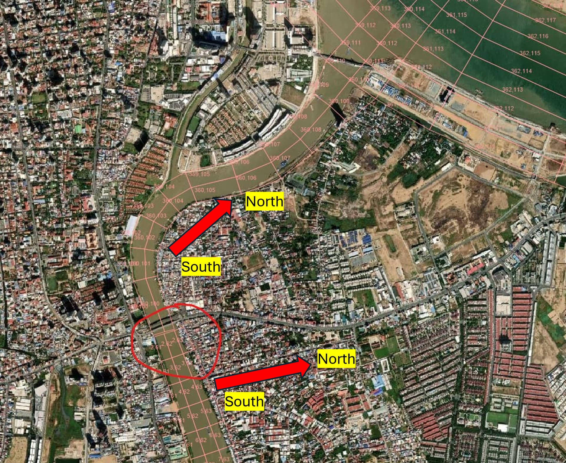

I’m experiencing difficulty resolving the grid connection issue using Grid+.

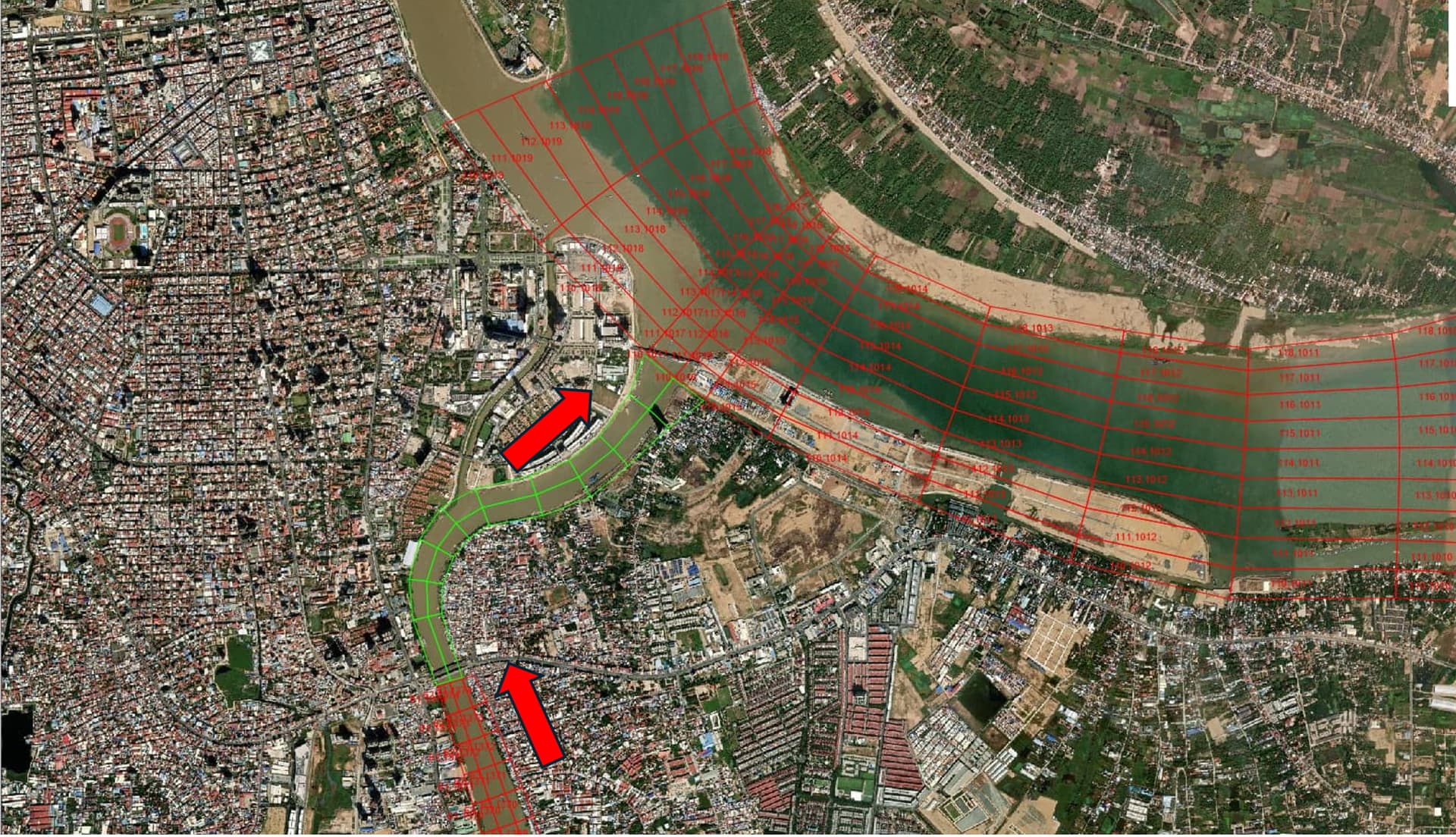

As shown in the image below, I need to connect the green grid to the red grid. However, I haven’t found a way to connect both the top and bottom parts of the green grid to the red grid simultaneously.
It seems that the “Merge Two Grid” function doesn’t allow me to include both ends of the green grid into the red grid at the same time. If I merge one side successfully, the other side becomes disconnected.
If there are any video tutorials or manuals that you could recommend regarding this issue, I would really appreciate it.
Thank you very much for your support.

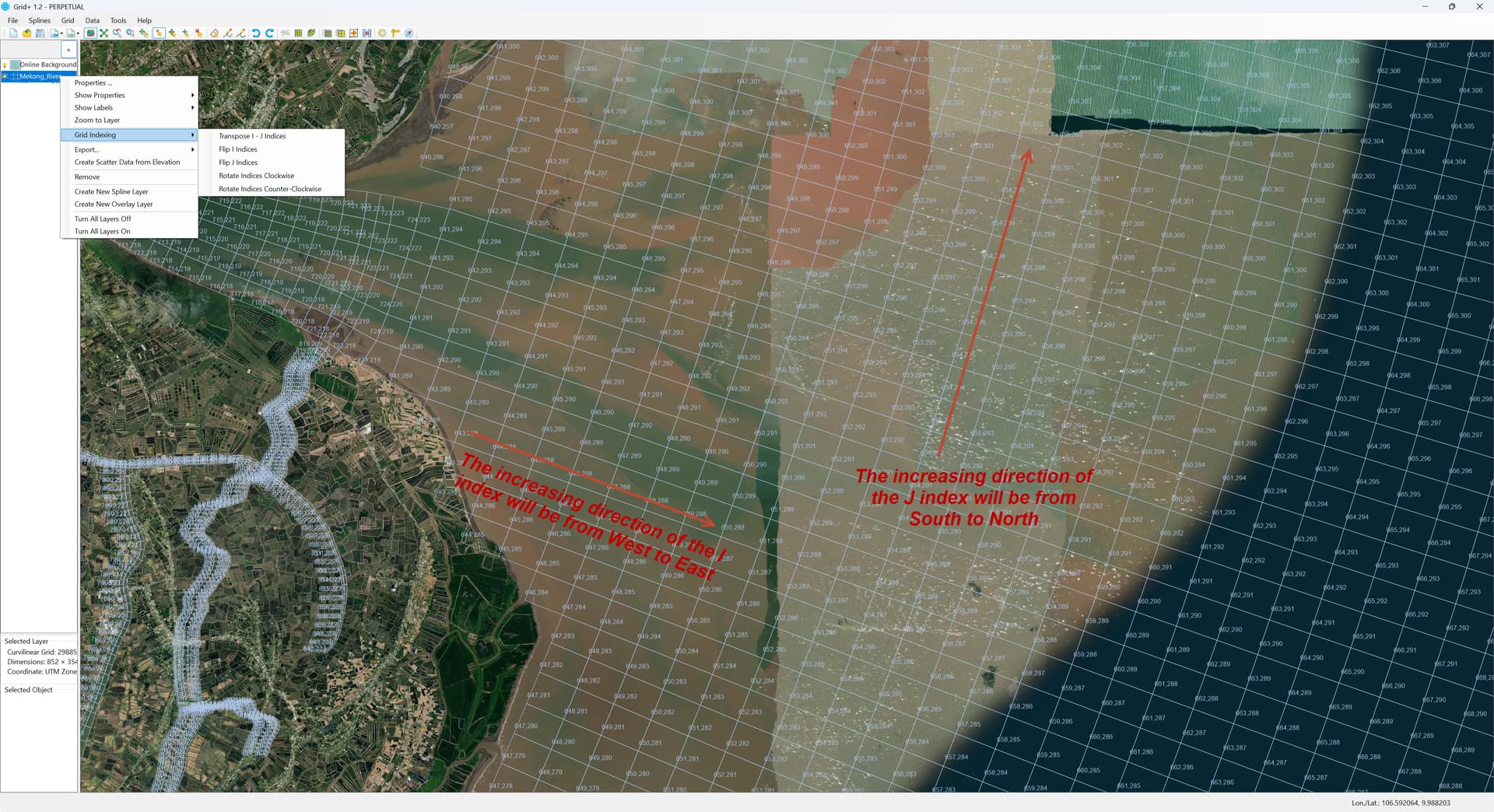

Hi sangwooda1992
Please make sure that only 2 grid layers are displayed/active and they are close to each other in this case. The increasing direction of the I index in the blue grid needs to follow the arrow direction as shown in the attached image.
Also the number of grids to be added/merged here must be appropriate, that is the number of grid cells to be joined will be equal to the number of grid cells already joined (if any) in the other area.

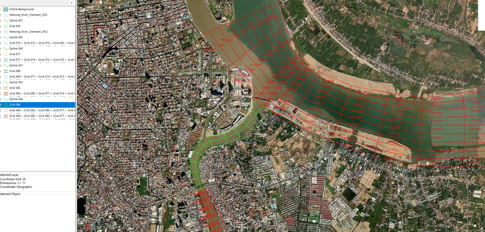

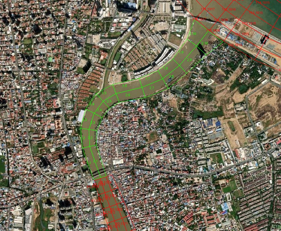

Thank you very much for your response.

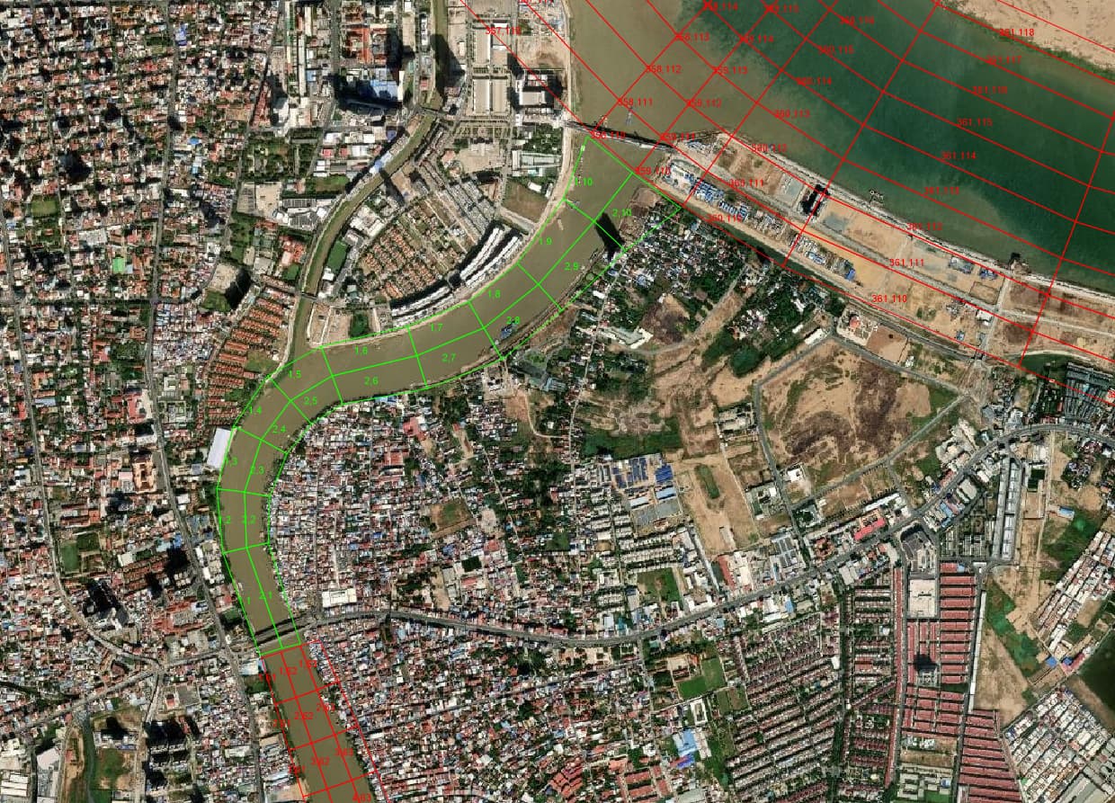

However, I’m still unable to resolve the issue. Based on my current setup, the I and J indices seem to follow the correct direction, as indicated by the arrow in the image.
It appears that the indexing aligns with what is required.
Still, I’m facing the same problem: I cannot connect both the upper and lower parts of the green grid to the red grid simultaneously. When I connect the upper part, the lower part remains disconnected, as shown in the image below.
I suspect this might be an issue related to the grid index arrangement.
Is there a way to modify or adjust the indices manually so that both connections can be established properly?
Hi sangwooda1992
Based on the image you provided, it can be seen that the grid at this position cannot be connected, because their dimensions are not the same (details see attached image). For more details, you can import the mesh into EEMS and view it under Cell Map mode, you will know more clearly the changing direction of each grid part. Based on this, you can rotate the angle appropriately before connecting them together.

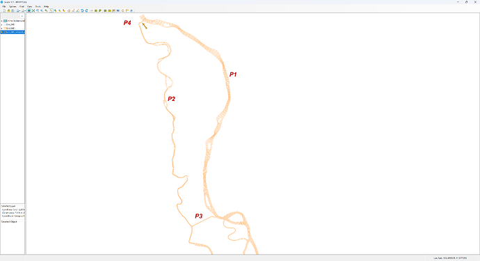

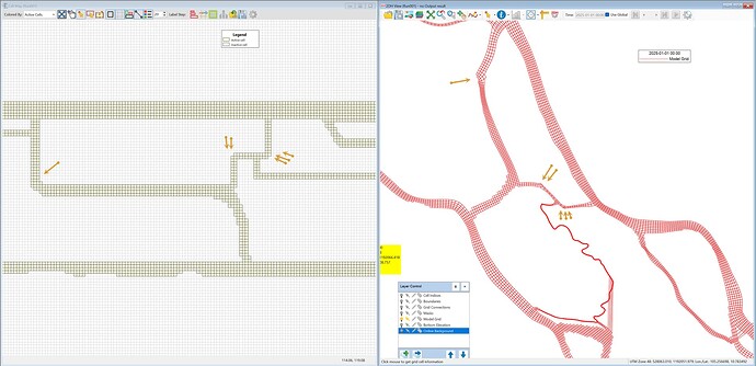

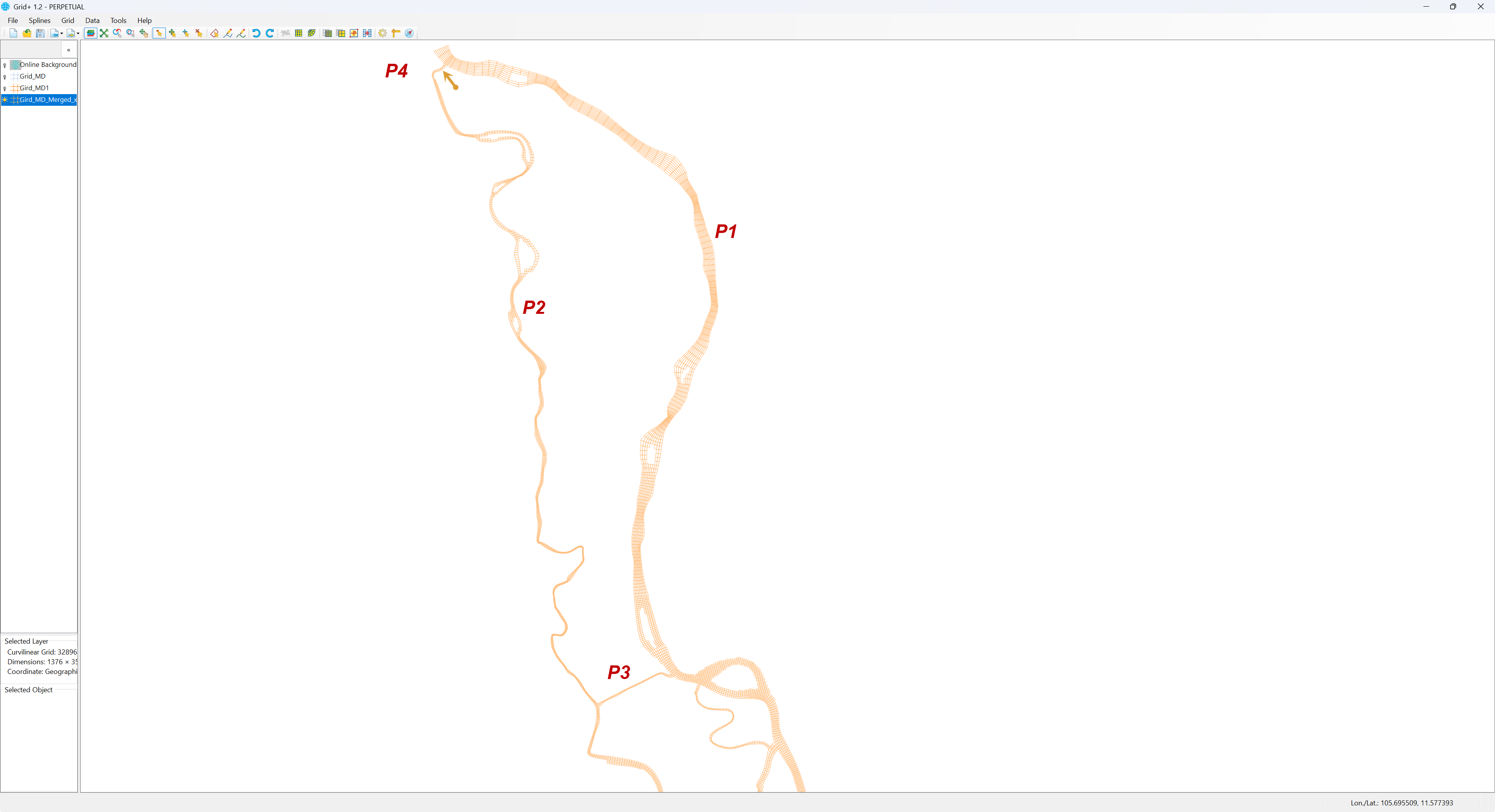

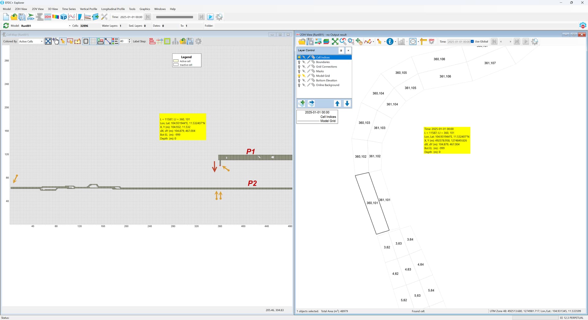

Hi sangwooda1992

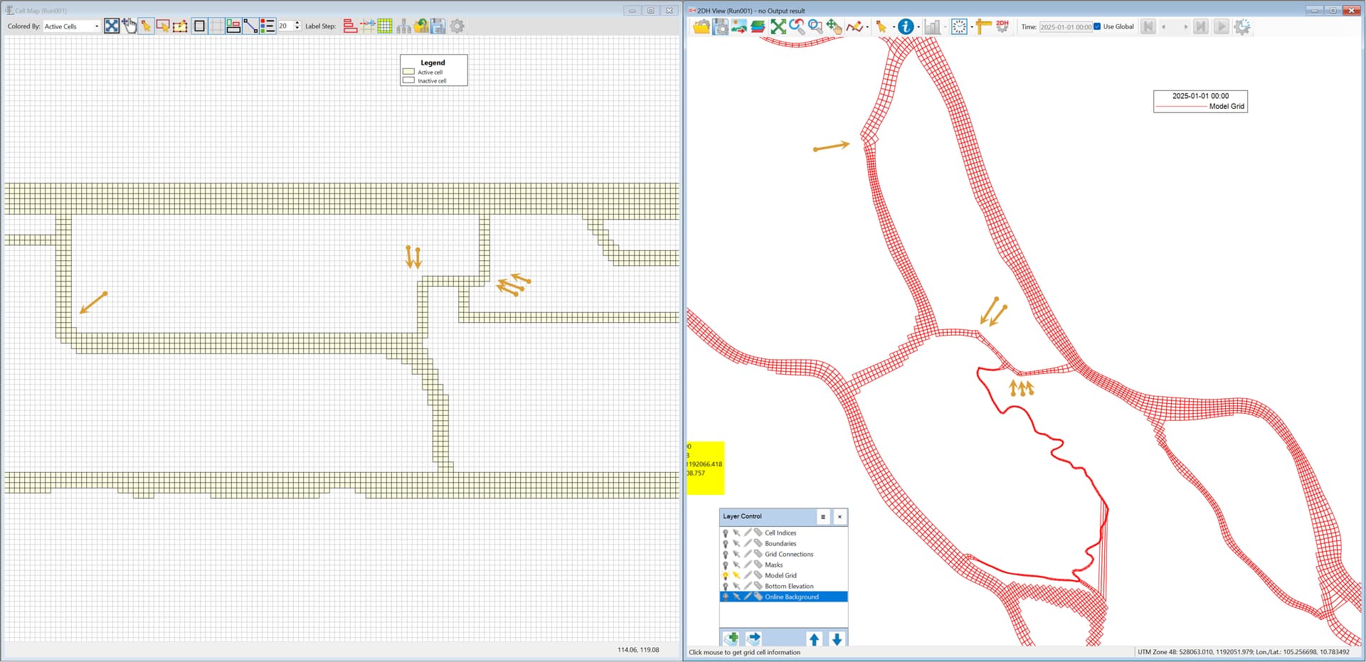

Import your gris into EEMS and then view it in Cell Map mode on EEMS. The image below is from your gris, you want to connect these two grid areas together but the number of grid cells is not equal,
so they cannot be connected in the remaining part. Consider the grid cell with index L=11587, if you expand this part of the grid to be able to connect,
it will connect and grid part P2 but in the middle (the position of the 2 yellow arrows), the reason is that the number of grid cells in P1 and P2 are not equal.
To understand it simply like this. You want to connect the position indicated by 1 yellow arrow together, then you have to increase the number of grid cells in P1 to equal the number of grid cells in P2
(the number of grid cells needed is based on the information I, J (on the X, Y axis)).
Look at the attached image below, you need to increase the number of grid cells in part 1 or decrease the number of grid cells in P2 so that their number of grid cells is equal. Also increase the number of grid cells in P4 to equal the number of grid cells in P3, so they can connect to each other normally.

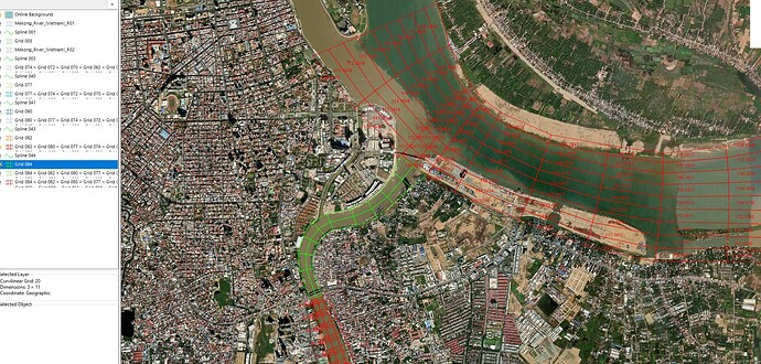

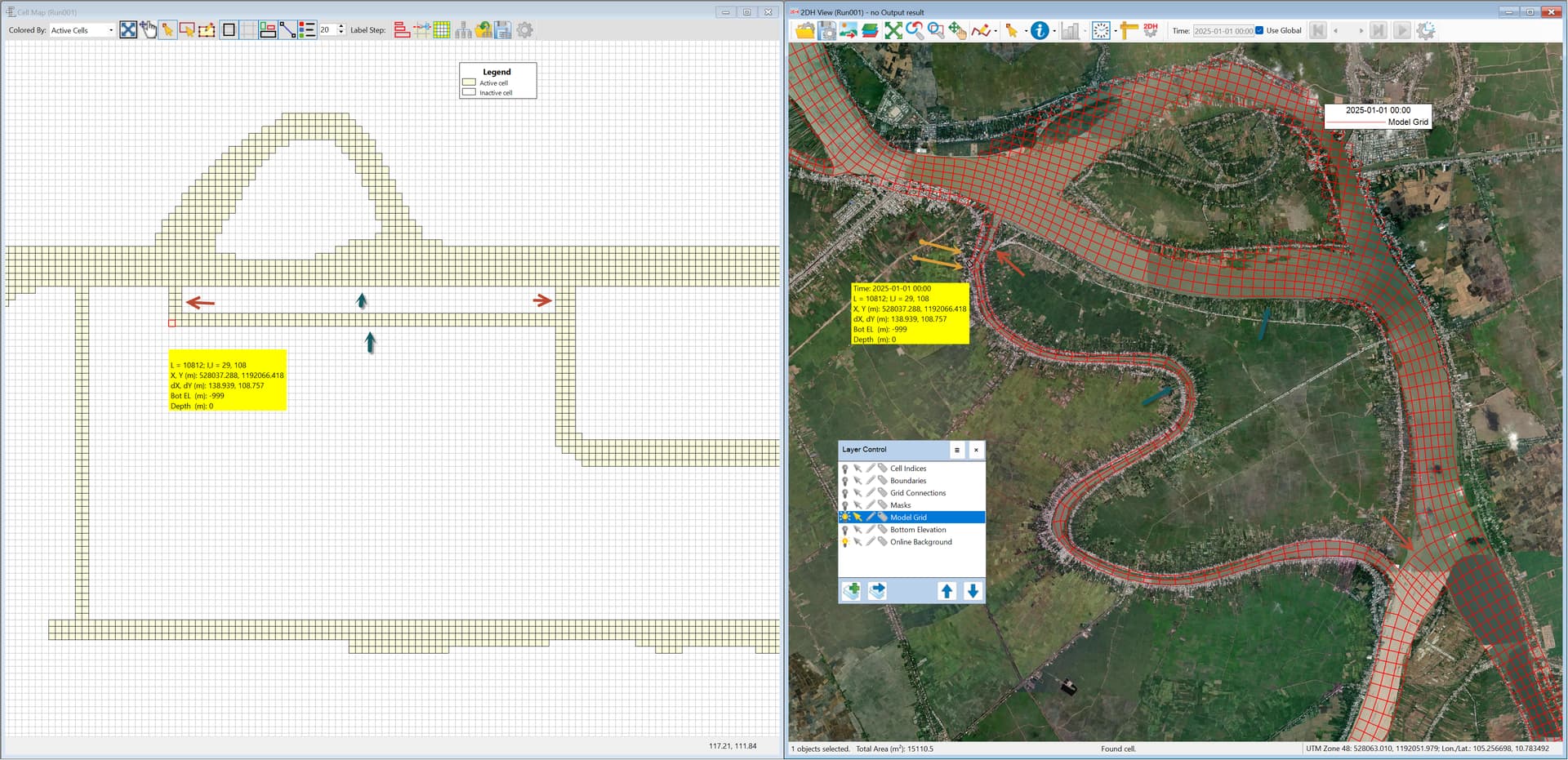

Thanks to your kind explanation and other support team members, I was able to understand how to connect cells using Grid+. I was able to create a fully connected Grid as shown below.
Thank you for your help.
