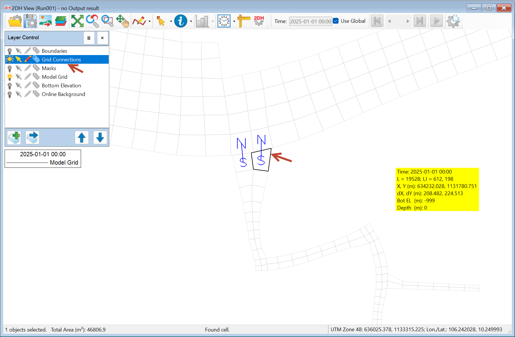

I am familiar with how to merge two grids. However, as shown in the image below, when I merge the upper part of the pink grid, the lower part remains disconnected, resulting in a single grid that is not fully connected.
What I am aiming for is a merged grid where both the upper and lower parts are properly connected.

1 - The connection on EEMS is used to indicate the cells that need to be connected for EFDC+ to understand and there will be water/salt/temperature exchange… between the connected cells, even when you export the connected grid file from EEMS to an external file, the connections will not be shown on GRID+.
2- There is absolutely a way to connect in GRID+ without connecting on EEMS. As I said in the previous answer, to be able to connect, the I, J indexes need to be continuous and directed towards the remaining cells, you can see this on the Cell Map function. See my attached image as an example, if I expand the grid cells along the arrows, the grid cells will be connected to each other.

In cases like the example below—where both the top and bottom parts need to be connected simultaneously—can such connections be handled directly within GRID+ without using EEMS’s Grid Connection functionality?
My ultimate goal is to complete all grid-related tasks entirely within GRID+ without importing or exporting through EEMS.

for your grid can be handled on GRID+ I suggest the following steps:
1 - Cut your current pink grid into 2 parts (Part 01 and Part 02)
2 - Connect Part 02 with the blue grid, note that the number of grid cells in the 2 parts indicated by the 2 red arrows must have the same I or J index.
3- Rotate the corner at the grid cut position in Part 01 and create a grid number with the same I or J index as the grid cells in the newly connected grid, I mean the number of grid cells in the I or J direction on the area indicated by the two yellow arrows must be the same.
4- then connect them together,
try the above method if you still can’t solve it send us the grids via the support team email, I will review them.
