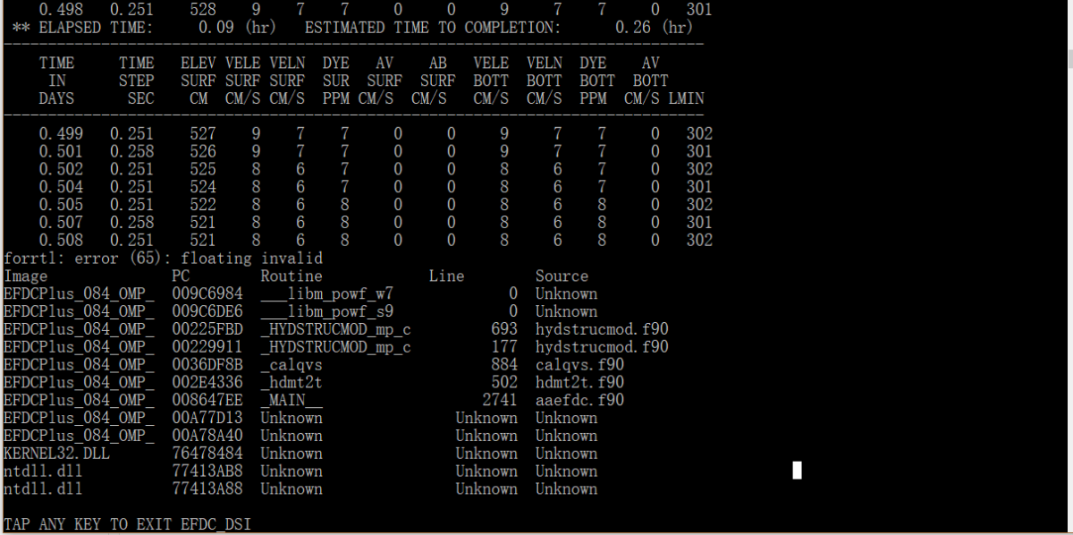

Hello everyone:Have you ever encountered this situation? How did you solve it?
try to turn down the time step
thanks
and also try to set the Wetting and Drying parameter like this photo.
Please look at the Figure 25 for the setting.
