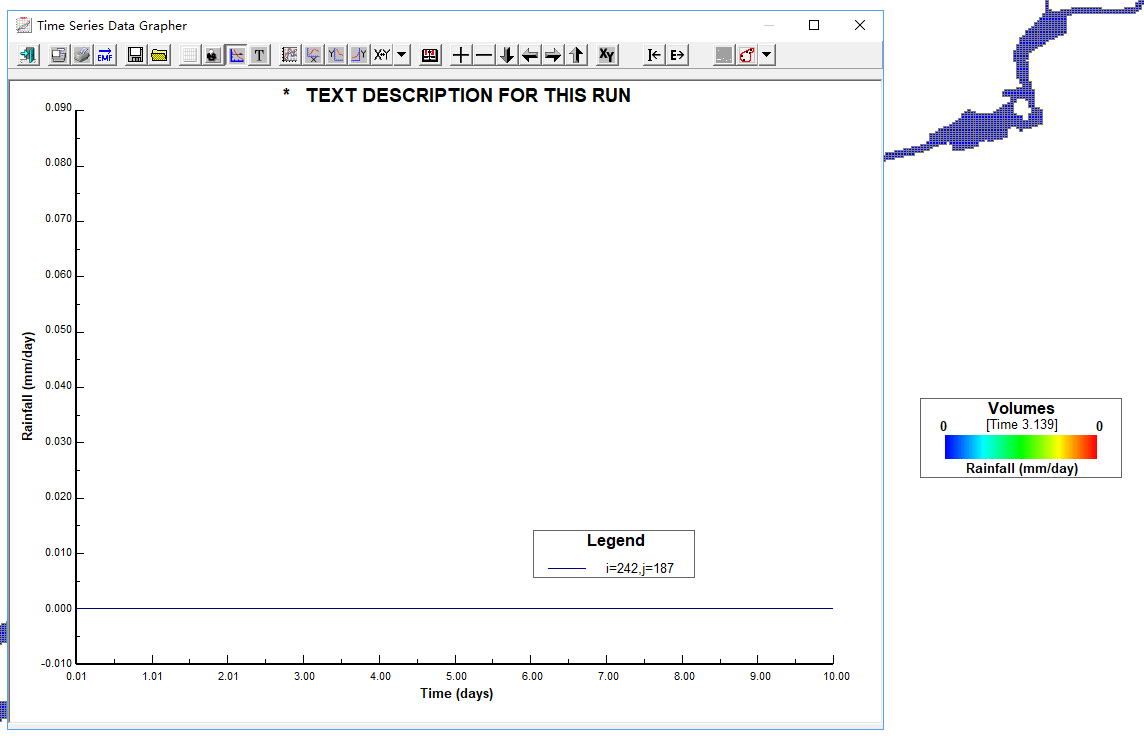

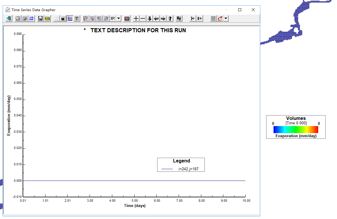

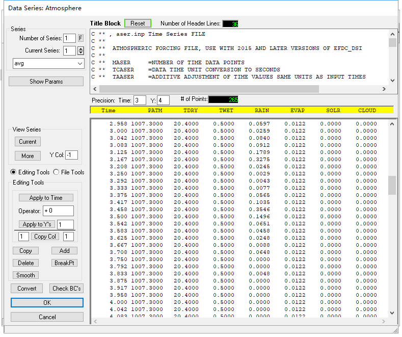

Hi, I do set up evaporation and rainfall in the atmosphere, why the evaporation and rainfall in the model results are still 0?
There are settings in the Temperature module (“General & Data” tab) to turn on the rainfall and evaporation part of the mass balance (“Evaporation options (Water Balance Only)”). If this is set to ignore the evaporation from the ASER.INP file, then the terms will be 0 in the model results.Please have a look at these pages on the knowledge base: https://eemodelingsystem.atlassian.net/wiki/spaces/EEREF/pages/2380150/General+Data
