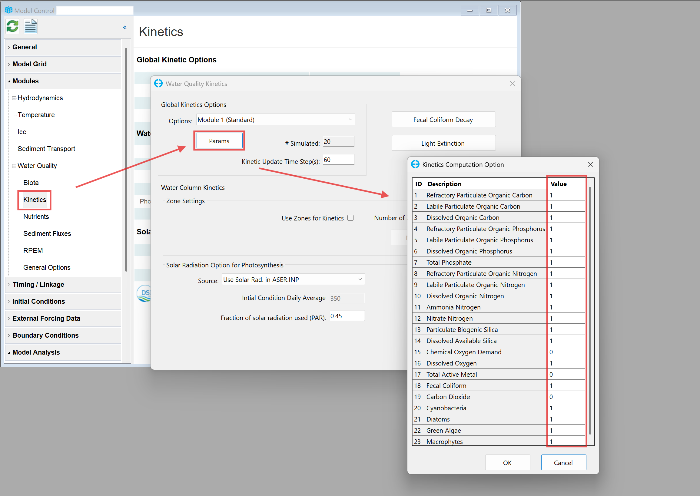

Hi @cherries0916
Yes, EFDC can simulate water quality without algae. You can do this by setting the computation option as 0 in the Kinetics Computation Option table below.
Could you confirm that your interested constituents are activated properly in this table?
